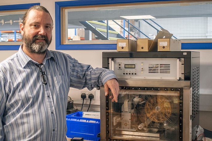

My visit was prompted by a particular development in DAC technology, the research unfolding in over the past year. Experiments with a novel discrete ladder DAC, guided by a belief that selected discrete resistors could sound better than the generally silicon nitride resistive elements used within integrated circuits, led to the design and built of an automatic computerised resistor tester to select from thousands the precise values required to make a DAC of the required precision.
​The favoured resistor technology would not allow laser trimming as is sometimes done. A prototype NOS discrete DAC has now been built where the zero crossing and array switching issues are now addressed and where the trimming of the last bit is allocated to a precision multi-turn resistor. It sounded very well indeed with Kegon triode electronics, promising a step beyond the existing Level Five. The latter uses a selected Analogue Devices 18 bit linear DAC. However there is still much work to be done on this new DAC before its eventual release.

Вот только TКС большой, длинные выводы - индуктивность, при R=1 кОм - влияние сопротивления ключей значительное…
Машина по подбору резисторов для R-2R ЦАПа.
