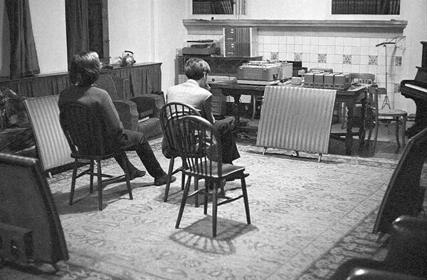

Surround sound from two-channel stereo
Michael Gerzon, ‘Surround Sound from Two-Channel Stereo’, Hi-Fi News, Vol. 15, pp. 1104-1109 (August 1970) [http://www.audiosignal.co.uk/Resources/Surround_sound_from_2-channel_stereo_A4.pdf]
