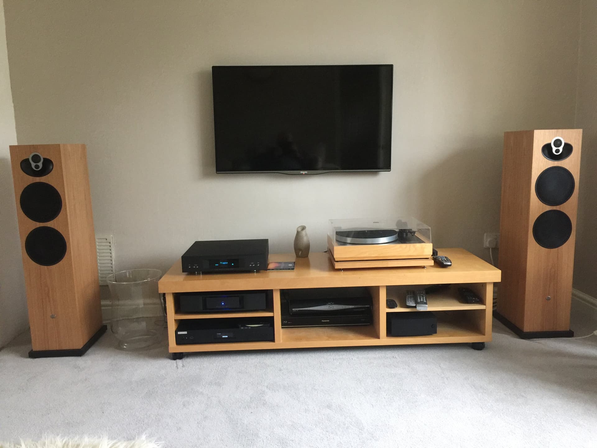

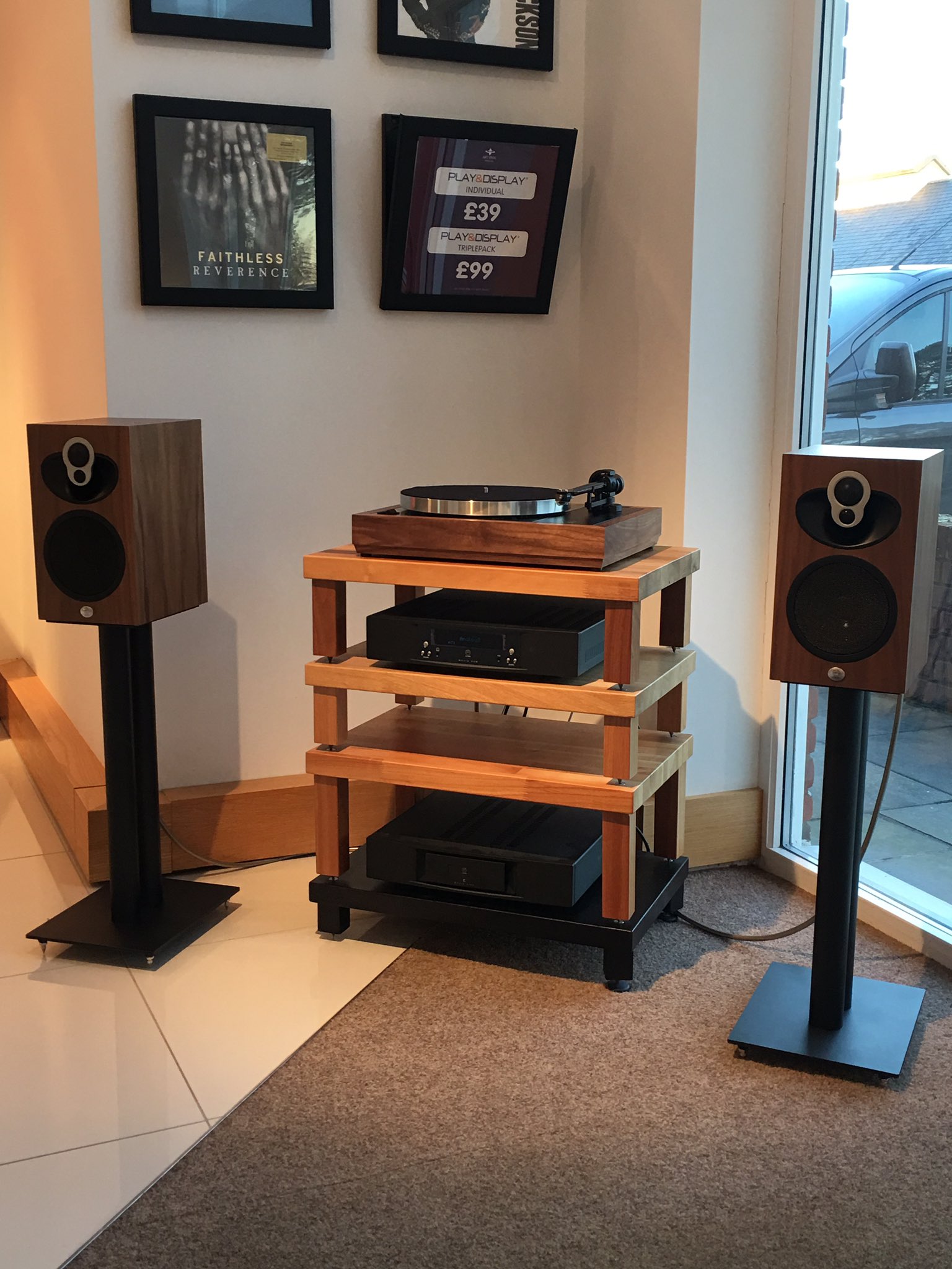

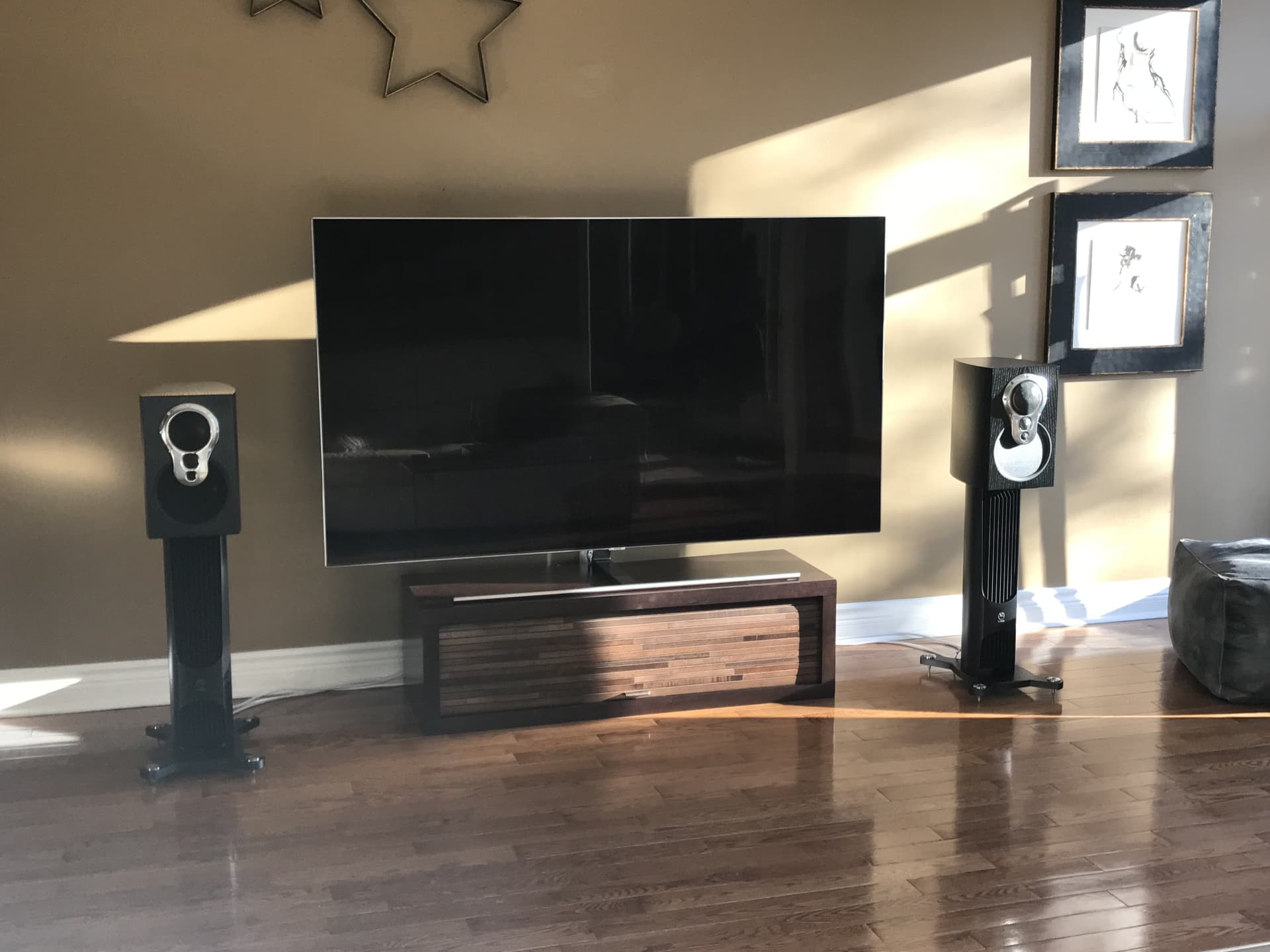

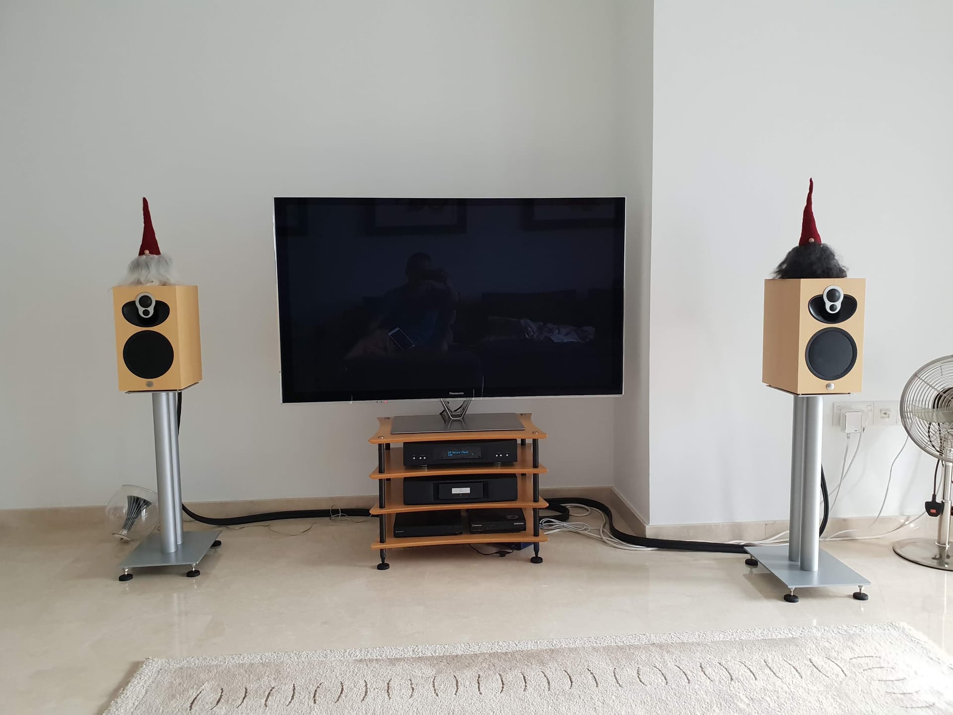

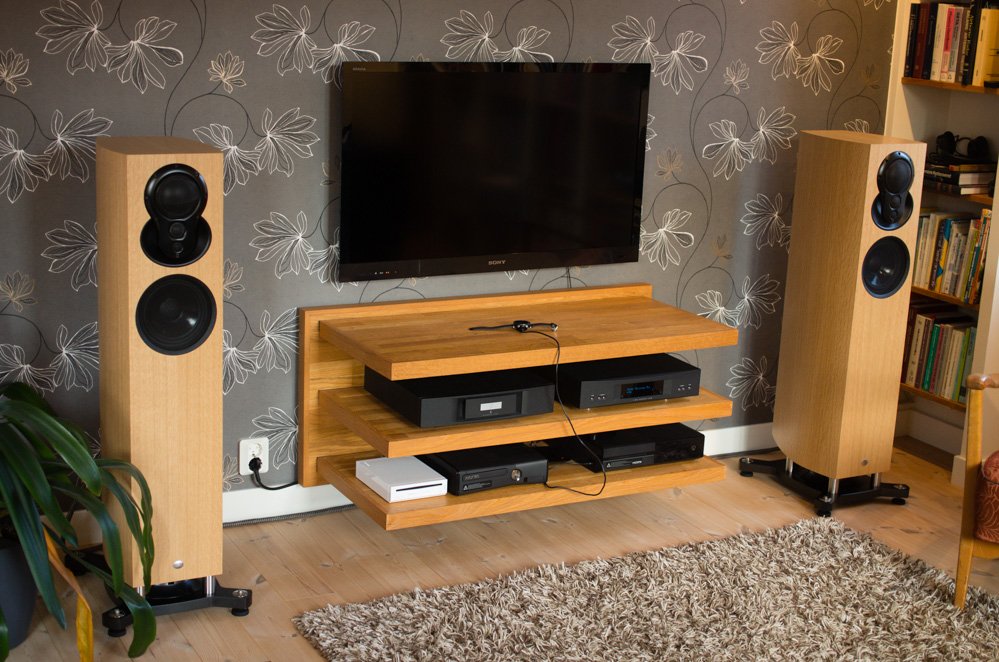

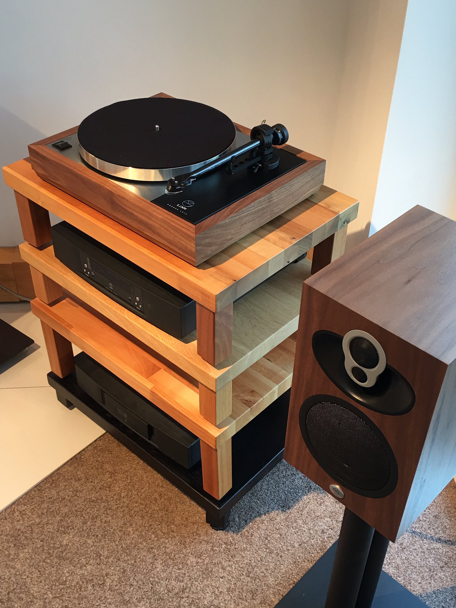

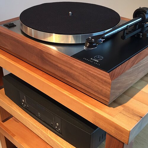

Посмтрел на днях, что наши зарубежные коллеги используют за системы
Whilst they may not image as well as the Living Voices, produce vocals as well as the Harbeth’s or sound as sumptuous with classical music as the Sonus Fabers they get 90% there with all the categories to me
В общем решил себе собрать полную Linn систему. От пассива до актива. Stay Tuned
